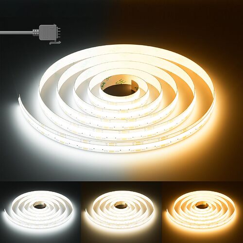

I used with these parts
LED Strip COB CCT

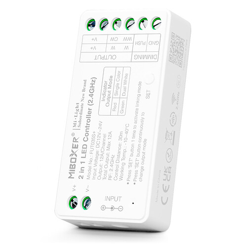

Miboxer Controler
