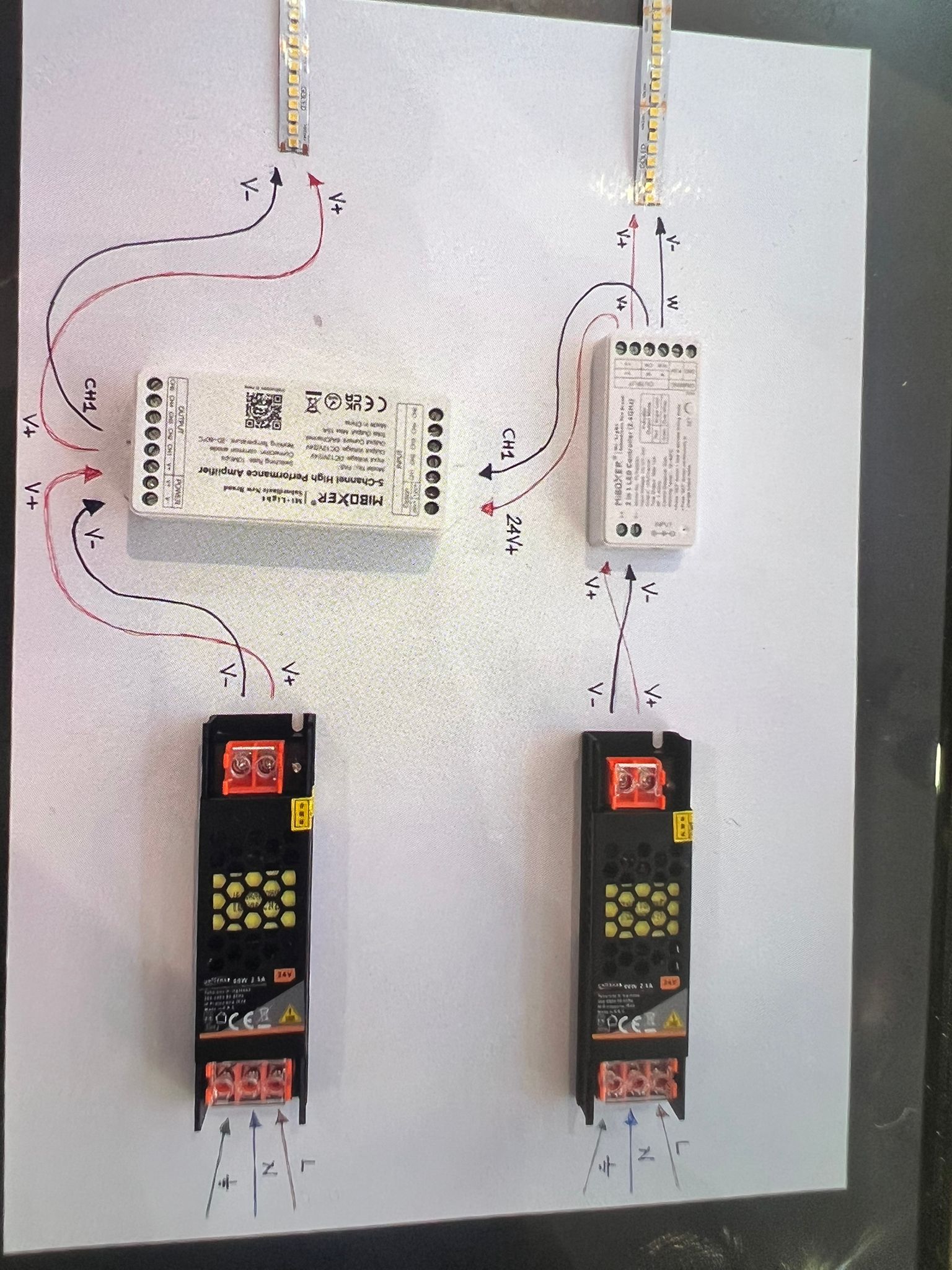

Hi all, I have a very simple configuration based on K2S remote and FUT035W+ tied to a fixed 4000k strip.
The remote paired soon but it only dims from about 80% to 100% and also using the on-off button the light doesn’t turn off but decrease to 80%.
Since I’m controlling 2 strips, there’s a double PSU and also a PA5 amplifier cabled as per the attached image (given to me by the vendor).
Am I missing something ?
