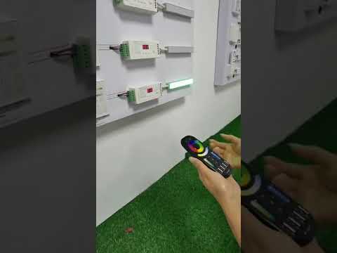

Hello friend,
Yesterday’s information was wrong. We have confirmed with engineers that the 2.4G remote control is compatible with the DMX512 controller.
For example, you assign the light strip to group one, press and hold the ON button of group one until the indicator light keeps flashing, and then use B4 to pair.
Below is the video link, please click to view details.
thanks for your answer, but no succes ![]()
Which indicator light - small red dot on X5 or all led strips? Nothing happend ![]()
EDIT:
WORKS!! BUT!! In my case solution was that:
I have everything conected to X5 and switchnig ON or OFF on “ALL” or “CH1” and both buttons CAN NOT go to pair mode. BUT, when I pressed and hold ON button on “CH4” on X5 it goes to pair mode and connection with B4 was established as shown on the vid.
Now on B4 I can do the same things as on X5. On “ALL” or “CH1”.
Both remote controllers paired successfully. THANKS!!!
