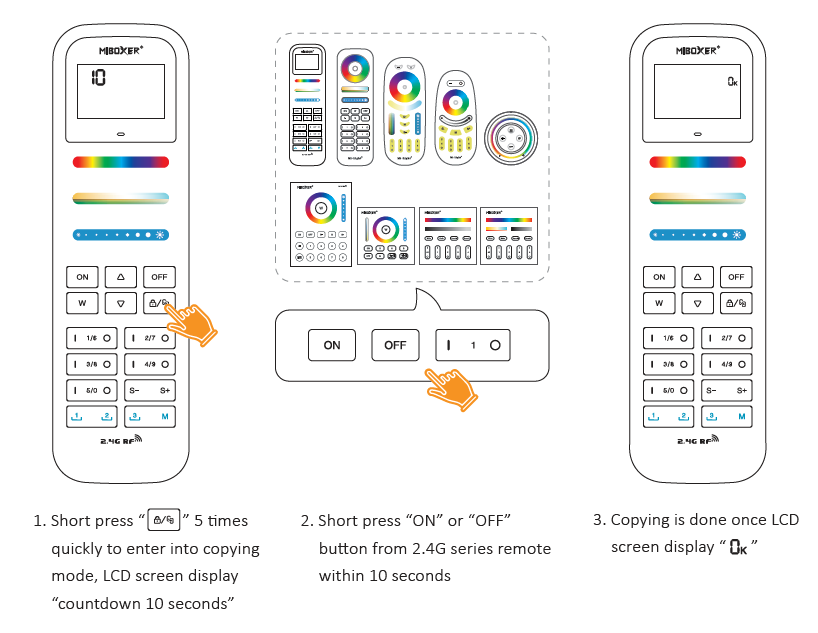

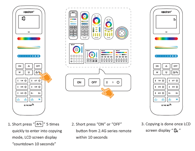

that is correct, but I have tried all the programming methods and repeated, the fue38s will not link to the fut100. I even unlinked the fut96 before trying and I also tried copying the linked 96 over to the 100 but the 38s don’t respond to the 100.
Please copy the code from FUT096
I said I have tried this already, the fut36s don’t link.

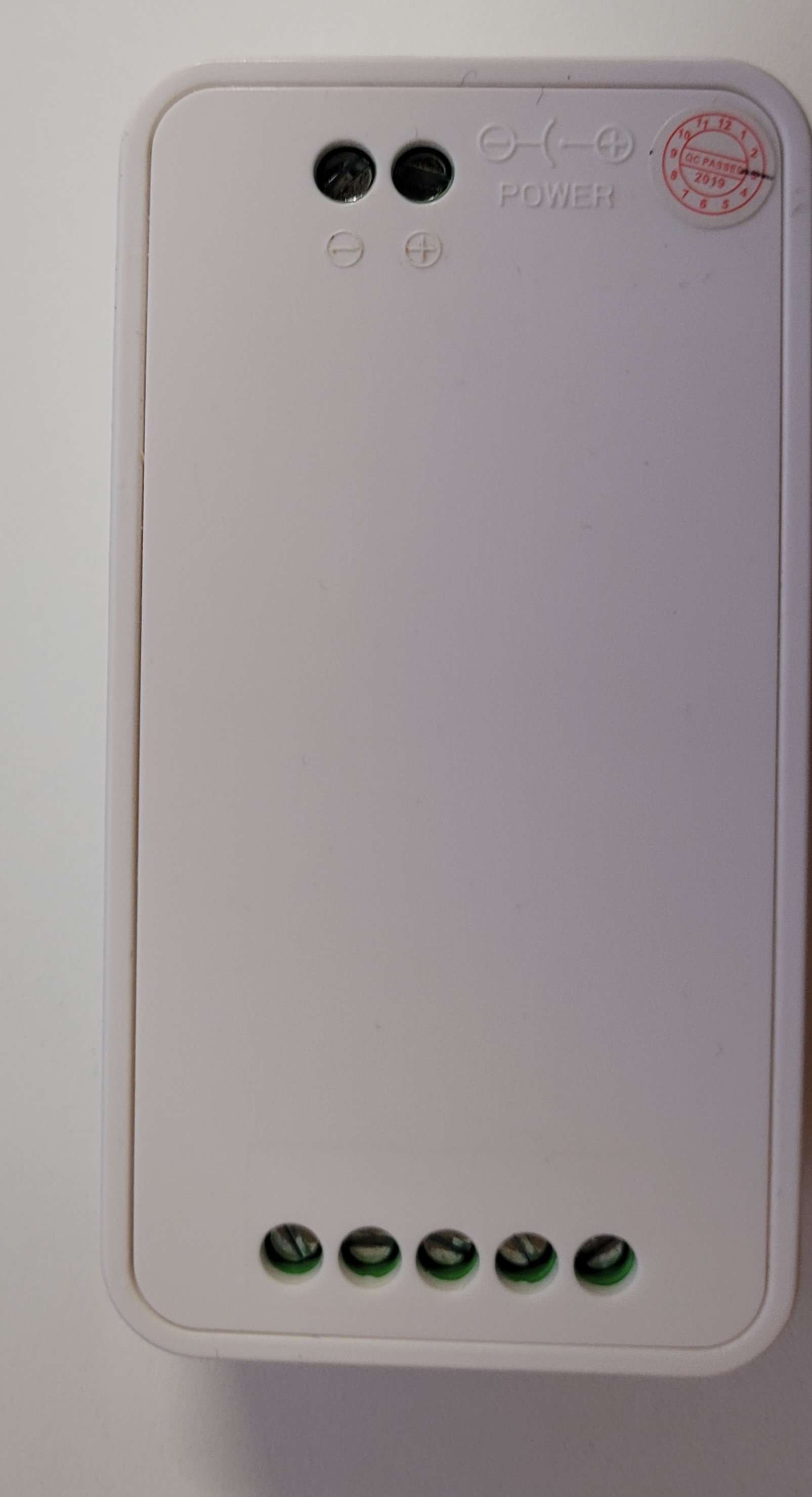

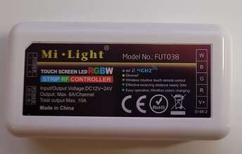

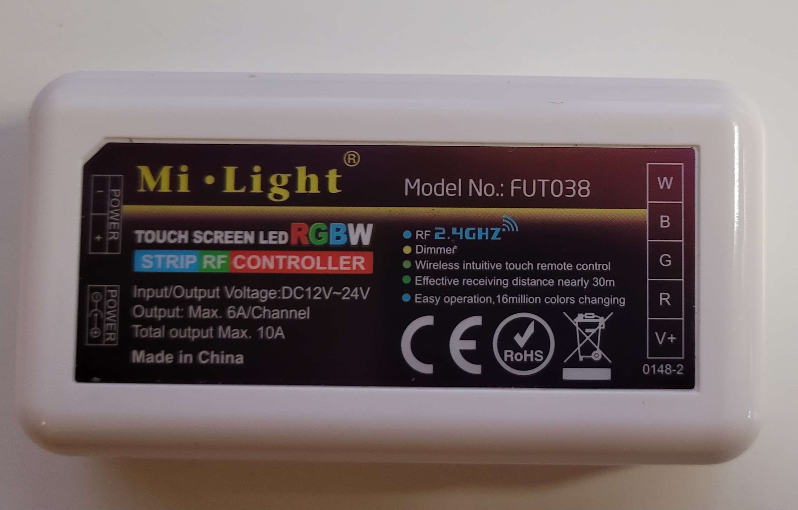

FUT100 is only compatible with those products over V2.0. We believe that your FUT038 is old type which can not pair with FUT100.
You can check the sticker on the controller, is there any V2.0 or V2.1 symbol ?
I don’t see a version symbol at all. The QC check sticker says 3/2019
Your current controller FUT038 can not pair with FUT100 since it’s very old type which produced in 2019 year.
