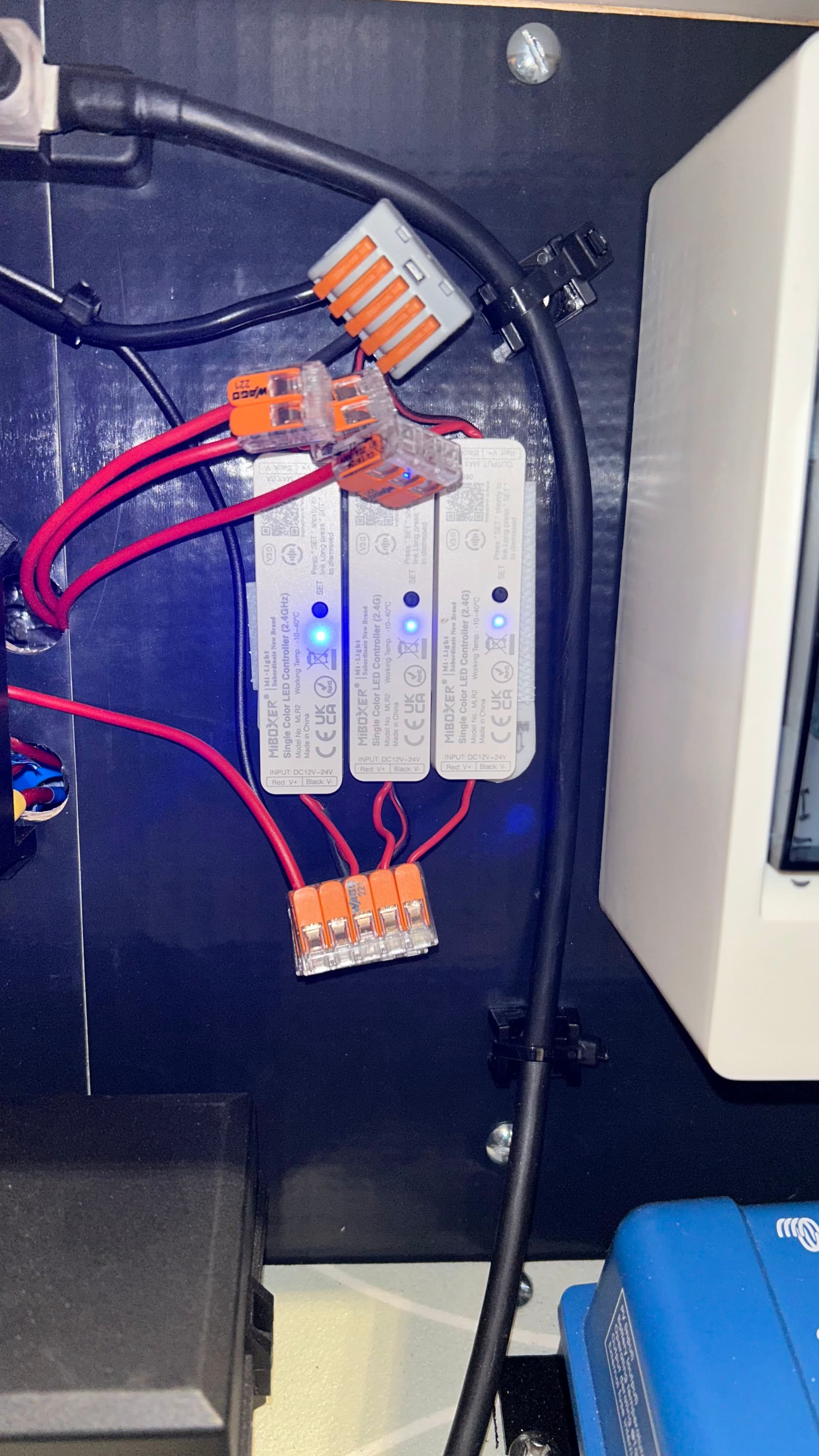

Hello, I’m new to miboxer. Please help me because clearly I’m doing something wrong way.
I’m trying to connect 3x MLR2 to C1 pilot, and no matter how I try to configure C1 pilot, I can’t control them separately. They all turn on/off at the same time using C1 pilot buttons ON/OFF but also on 1-2-3-4 buttons as well.
Connection scheme MLR2s:
IN: joint (-) AND joint (+), approx. 12,5-13,5V DC
OUT: joint minuses (-) for all 3 LED lights AND separate pluses (+) for all 3 LED lights.
My guesses what went wrong:
  1. They are too close to each other, so there is some radio inference?
  2. Minus (-) OUT for each MLR2 should be single and not joint together. I mean each (+) and (-) for each MLR2-LED should be connected separately. I connected only (+) separately for each MLR2-LED, but minuses (-) are joint connection.
